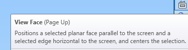

Let's say I get a part file from someone (please see attachment) and I want what the view cube is calling 'front' to be orthagonal to the 'front' of the model (see attached). That is, I want 'front' to be a square-on, orthagonal view. How best to align the model to achieve this?

I was unaware of the 'View Face' command (though embarrassingly, the icon's right in front of me). THANK YOU!
