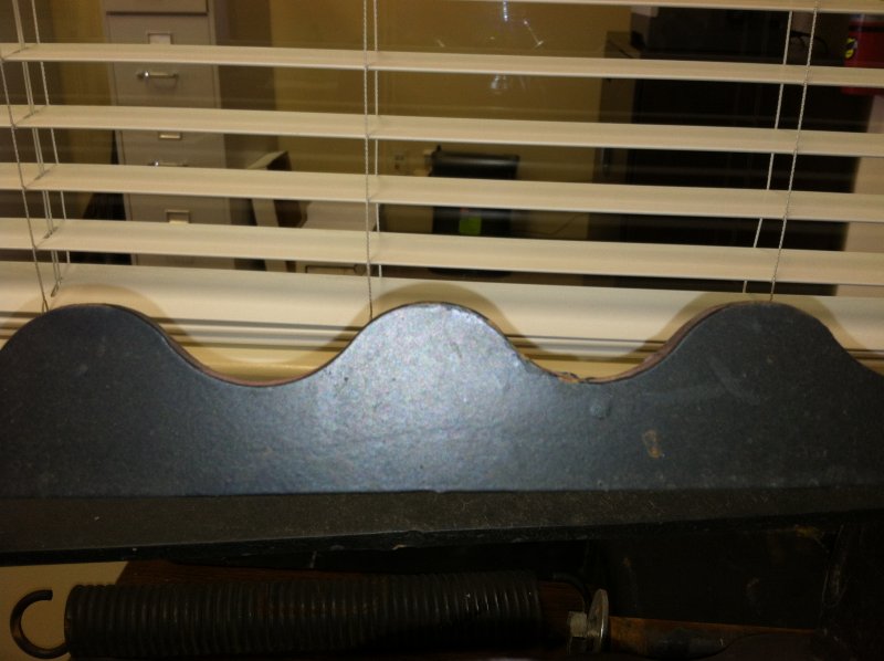

What would be the easiest way to get these curves the piece is long and it would take a while with circles. I have tried some other things and did not turn out all that well.
You can do this as part of a pline nominating an arc to be drawn instead of continuous point picks.
This is the code from a lisp that does it "pLINE" p2 "w" 0.0 0.0 "a" "ce" p3 "a" "-180" "l" p5 "a" "ce" p6 p7 "l" p8 the "Px" are pick points so with a bit of trial and error you should be able to work it out. I will see if I can redo it into plain Autocad.

It just draws a pline with curves its part of a lisp start end pt etc does in between. Search here for batting and insulation pretty sure full code examples are there, mine is copyrighted can not post.
