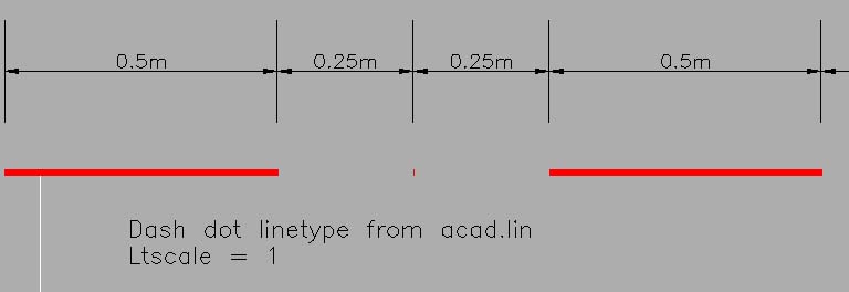

Hi everyone,
Look at the picture. How can I scale the line to show the dashes?
If a draw a bigger rectangle the dashes shows up... Is it possible to set a measure for each space?
What can I do? :unsure:
I'm drawing in Meters 1 = 1m.
Adjust LTSCALE to suit.
Are you using linetypes from acadiso.lin?
Yep. acadiso.lin

Edit - LTscale is what i was looking for!! =)))
Yes, Plenty on CADTutor for creating custom linetypes.
I usually use the acad.lin linetypes although I draw in metre units.
Those line types were written with simple scaling for the dashes and spaces, and are much easier to predict for scaling.

If you don't want to change the line type scale for every line, you can click on the desired line you want to change, type in "PR" or "PROPERTIES" or right click --> properties, find the line type scale and play around the with numbers there. Hope that helps.
