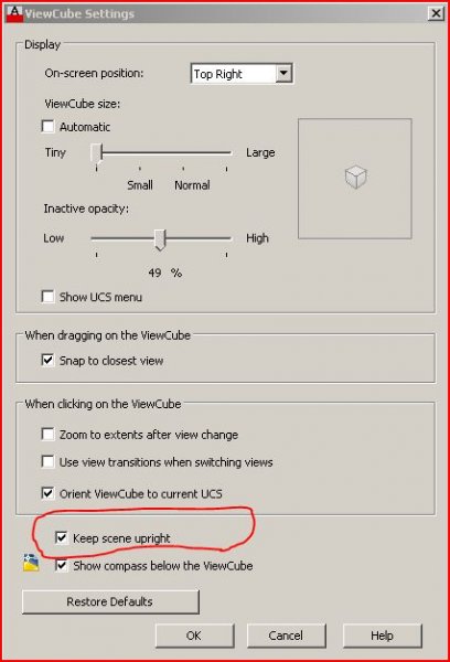

Might this be caused by your VIEW CUBE SETTINGS, as shown in the image?
Try unchecking KEEP SCENE UPRIGHT in your VIEW CUBE SETTINGS.

Keep scene upright, and snap to closest view seem to do nothing for me...

Nope, that didn't do it :huh:
