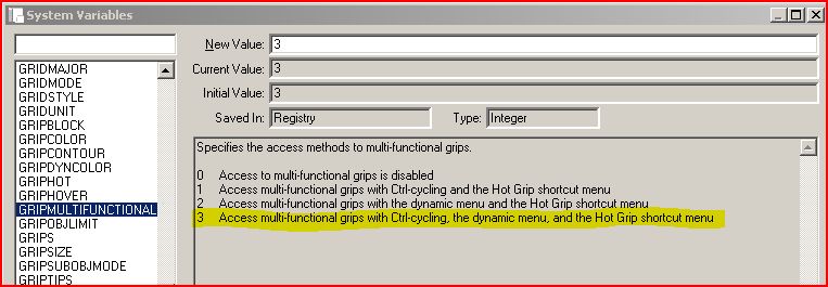

Set your GRIPMULTIFUNCTIONAL system variable at your commandline to 3. :)

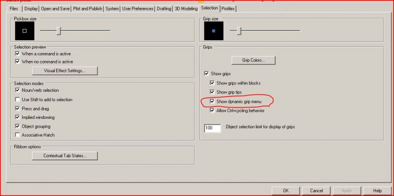

gripu.jpghttp://img193.imageshack.us/img193/7210/gripu.jpg

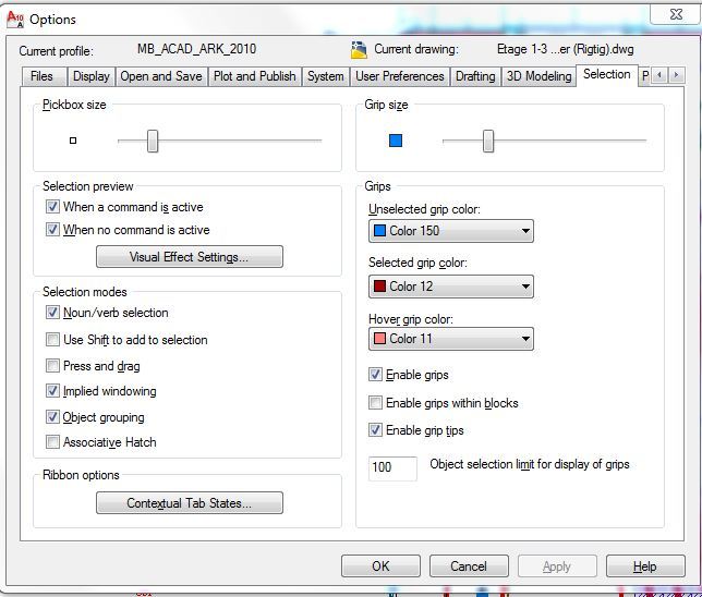

This is how my options looks like. Guess it's not really gonna work. As for the vertex i suppose i can use pledit to add a vertex instead.
Could there be a way to work arround the situation where i draw a polyline rectangle of 400x50 and i realize i want to make it 400x75 instead? Atm this is what i miss most, with the limited grip function.

I just went through the process of figuring this out. I first checked the GRIPMULTIFUNCTIONAL variable annd it was already set to 3. My fix was the GRIPS variable. It also has to be set to 2.
