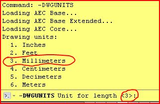

Dadgad Posted August 27, 2012 Posted August 27, 2012 Welcome to the forum. The unit displayed by the program will depend on your -DWGUNITS setting. Type -DWGUNITS at the commandline, include the hyphen, and your current DWG database units will be displayed, as in the image, which informs me that the drawing units in my current drawing are mms, so the MASSPROP command will return measurements expressed in mm units, either squared or cubed. Quote
