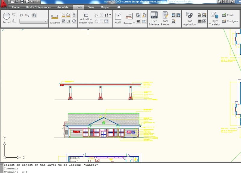

The format of my autocad screen was changed somehow overnight. Most likely an automatic upgrade through my company's server.
Anyway, It's got this horrible tab configuration that I've never used before up top (similar to my new internet explorer look). Plus my settings for things like my black screen and curser changed.
Is there any way to get this format changed back to the way it used to look, traditional pulldown's etc.?

That "tabbed" thing is called the RIBBON. LoL
I'm betting you ditched it in favor of the old school AutoCAD Classic with drop down menus (Menu Bar) and Toolbars. Am I right?
Have you tried changing Workspaces?
Workspace Switching icon located in your Task Bar at the bottom right hand corner of your screen.
Click on it. AutoCAD Classic should be one of the choices. Try that first.

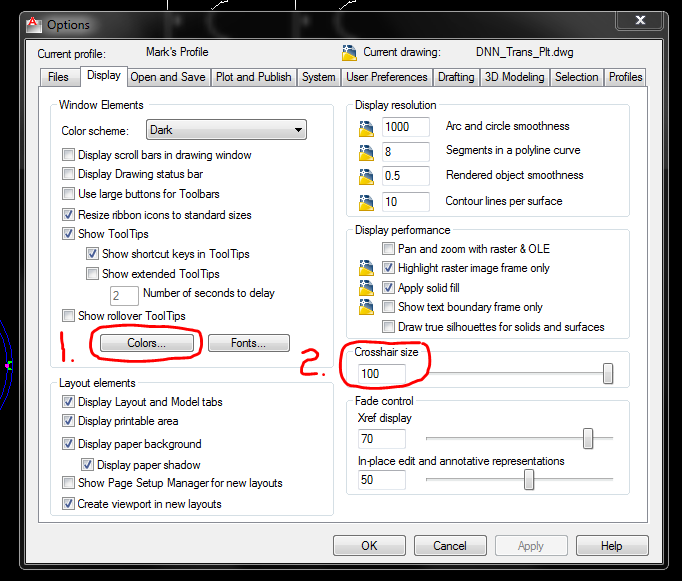

Tools > Options > Display tab.
1. Colors button. Click to get you to where you can change your background color if need be.
2. This is where you can change the length of your crosshairs if need be.

[ATTACH=CONFIG]36787[/ATTACH]
