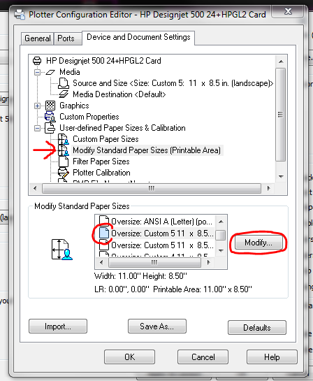

I am curious if there is a way to plot longer than 600"? When I try to set the length to 1200" I get the following error.
"One or more custom sizes are invalid given the selected configuration for this printer"
I am using an HP Designjet 1050C.
A 100 foot long plot. OK. Did you create you own custom size? This look familiar?
I have tried, but when I hit ok, I get the error message above.
And yes, the 100' plot if for a natural gas well log.
Does your plotter give you a choice like mine shown in the graphic in post #2?
Use the Custom Properties choice further up, on an HPT770 I can specify a length of 3520.68. You are on a 1050C so that may be the limitation for that model.
