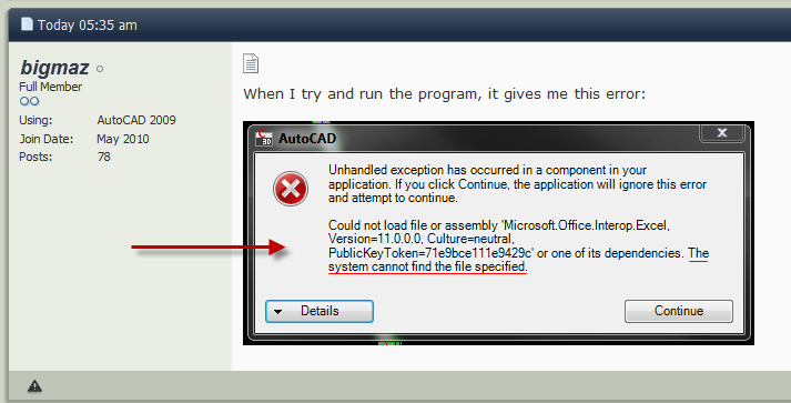

bigmaz Posted August 30, 2012 Author Posted August 30, 2012 When I try and run the program, it gives me this error: Quote
BlackBox Posted August 30, 2012 Posted August 30, 2012 ... That's because the plug-in has a reference to the Microsoft.Office.Interop.Excel Library, and it (the dependent reference) cannot be found on your system. I'll see what I can do to provide an adaptation that does not have this dependency, and instead uses basic .CSV instead. Quote

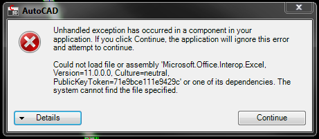

bigmaz Posted August 30, 2012 Author Posted August 30, 2012 [ATTACH=CONFIG]36852[/ATTACH] ... That's because the plug-in has a reference to the Microsoft.Office.Interop.Excel Library, and it (the dependent reference) cannot be found on your system. I'll see what I can do to provide an adaptation that does not have this dependency, and instead uses basic .CSV instead. That would be fantastic, thank you very much for your help Quote
