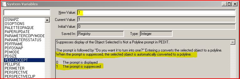

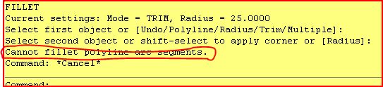

Dadgad Posted August 30, 2012 Posted August 30, 2012 Hello careca, welcome to the forum. If you set your PEDITACCEPT system variable setting to 1, at your commandline, then you will be able to fillet the offset entity by using the POLYLINE option in the FILLET commandline prompts. I hope that helps you. Quote
careca Posted August 30, 2012 Author Posted August 30, 2012 Hello careca, welcome to the forum. If you set your PEDITACCEPT system variable setting to 1, at your commandline, then you will be able to fillet the offset entity by using the POLYLINE option in the FILLET commandline prompts. I hope that helps you. Hi Dadgad, thanks for your reply. I actually tried this, but it seems not to be working. The arc sections will be spared out when trying to do all at once via polyline. That's why I thought I loop though the selection set of elements... Martin Quote

Dadgad Posted August 30, 2012 Posted August 30, 2012 I see what you mean, I was quite surprised that when the BOUNDARY command creates a CLOSED POLYLINE, which having been OFFSET with the POLYLINE option, and despite having been a closed polyline, still yields the following message ..... another message that keeps coming up about one line having been divergent (polyline arc). Quote

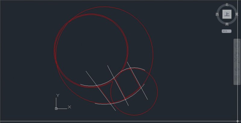

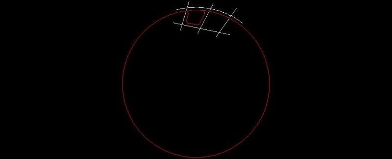

marko_ribar Posted August 30, 2012 Posted August 30, 2012 I tried to replicate case OP posted in jpg, and with your original it wrongly filleted last line with arc but only on left portion - one pick boundary; right one it did correctly... I suppose it has something with fillet - it don't know how to connect entities (line filleted with arc extending it to make almost whole circle) when they are supplied rather then mid points like in my modification... Quote

marko_ribar Posted August 30, 2012 Posted August 30, 2012 I am not laying, this is what I get - see attached files... Maybe its my netbook that can't do it correctly - don't know, please test it with posted dwg... M.R. xf.dwg Quote

marko_ribar Posted August 30, 2012 Posted August 30, 2012 But they are already flattened - they are drawn in 2d like usual... With Lee's code, sometimes it does correctly, but sometimes not... When I execute my code, then it's OK... Like I said it has something to do with the thing that when entities are supplied to fillet, it doesn't know on what side to do it, and when you supply mid points there are no mistakes... Please, don't check it with my code, but with firstly posted... M.R. P.S. I did test it on my other comp. A2012 and also results were the same... Sometimes it does correctly, sometimes not... Quote
careca Posted August 31, 2012 Author Posted August 31, 2012 (edited) wow - I feel flattered to see replies by such lisp experts dealing with by amateurish coding problem! well, i have tried both versions of the updated lisp, still they produce funny results: Lisp by Lee Mac: Lisp by Marko Ribar: maybe that's because I included a change of bending direction of one of the polylines... many thanks for your efforts, with my limited knowledge I will do additional testing. Edited August 31, 2012 by careca Quote
