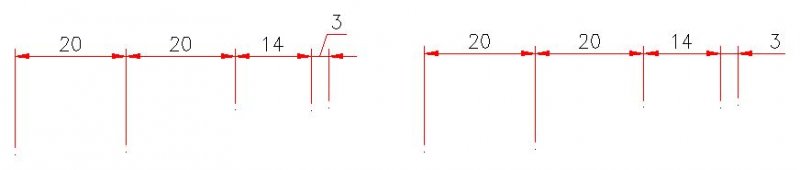

I really enjoy using the DIMCONTINUE command, as it is really fast.
The problem I have with it, is that it overrides the current dimstyle
defined, TEXT PLACEMENT setting, with 'ABOVE DIM LINE WITH LEADER'.
I would prefer that it honor the DIMSTYLE saved text placement.
As it works now, every time I finish using this for a string of continued dimensions I need to remember to select them all and reapply the current dimstyle from the right click shortcut menu.
If I don't, and there are any dimensions too short to accommodate the text and arrows, the leader is added, which I don't want.

Hi Lee, thanks very much for doing this, :)
but it seems I am still having the same issue.
Which seems to be that the DIMTMOVE value needs to remain 0, or be reset to 0 for any of the newly completed
dimensions, and the default behavior seems to switch it to 1, whenever the available space for the text
on the dimension line crosses the minimum threshold, instead of moving the text horizontally outside the arrow.
If I check the properties of a very short newly created continued dimension (displaying with the unwanted leader), in Properties it still says
it is the current dimstyle, :huh: BUT in order to restore that DIMTMOVE variable to 0, I have to click
dimension style in my right click shortcut menu and select the current dimstyle there, and that will reset it to
the TEXT PLACEMENT being beside the dimension line.

You're welcome, though that's odd since the code seems to work for me:
Yes Lee, that is a very compelling argument, I must agree. :huh:
Let me give that another try.
I see said the blindman!
I was using the ESC button to exit the command, instead of ENTER.
Wherever you go, there you are!
Working like a charm now, just needed to keep my eyes on the road, thanks very much Lee! :beer:
