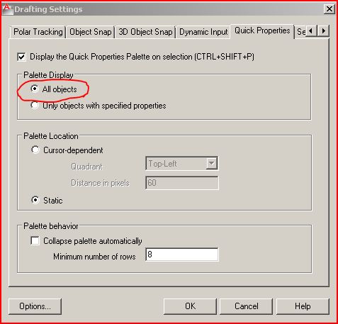

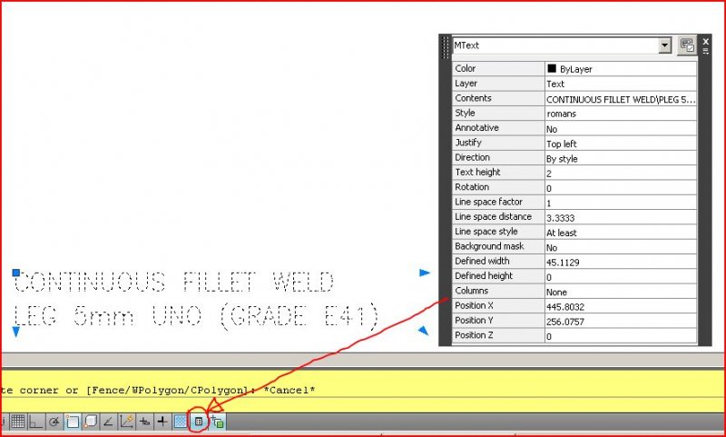

tommo73 Posted September 5, 2012 Posted September 5, 2012 hi, joined the forum as a last resort to a really infuriating (but probably simple problem) Juts had Acad LT 2009 re-installed on my new laptop, and all of my old settings, desktop preference etc have been wiped. No problem, couple of hours to set it back up. BUT When right-clicking on any object to bring up the properties, (line length, text height etc) the properties do not appear in the drop down box on the right, or in any 'quick properties' display It may just be a tick box somewhere, but any help much appreciated thanks NeilAcadProp.docx Quote

Dadgad Posted September 5, 2012 Posted September 5, 2012 Welcome to the forum. Might you happen to use TIME SENSITIVE right click? In OPTIONS (does LT have them?) on the USER PREFERENCES tab, you might want to explore the RIGHT CLICK settings. Typically LEFT click on an object to select it, at which point the QUICK PROPERTIES palette springs to life. Right click on the border of your quick properties palette, which will take you to where you set the properties which you want reported for different entity types. If nothing is checked, then nothing would be reported. Quote
tommo73 Posted September 5, 2012 Author Posted September 5, 2012 hmmmm I think i 'may' have found a problem when i try entering 'dsettings' in the command line or clicking on the settings tab as described above, i get the message 'unknown command' I have a feeling something is missing from my Acad files from the install Maybe a full re-install is the answer? Quote
