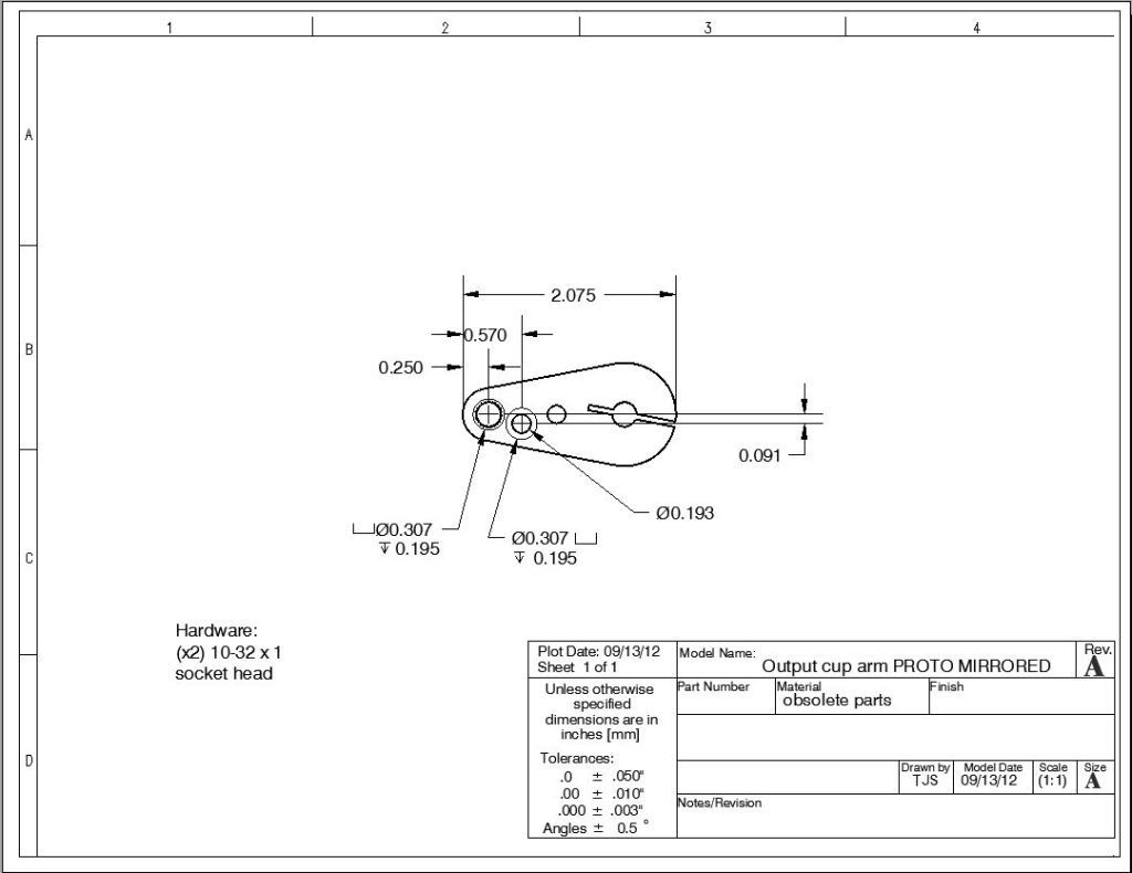

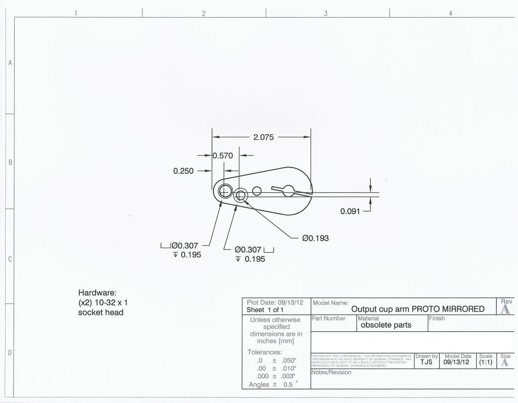

Here is a quick part I'm modifying this morning - 2 images. The first is a screenshot of the plot preview, the second is a scan of the print (printer is a modern HP Officejet 7500A). I also tacked on a screenshot of the Plot Options Box.

Screenshot prior to plotting:
Scanned print - notice the dimensions are offset down/left:
