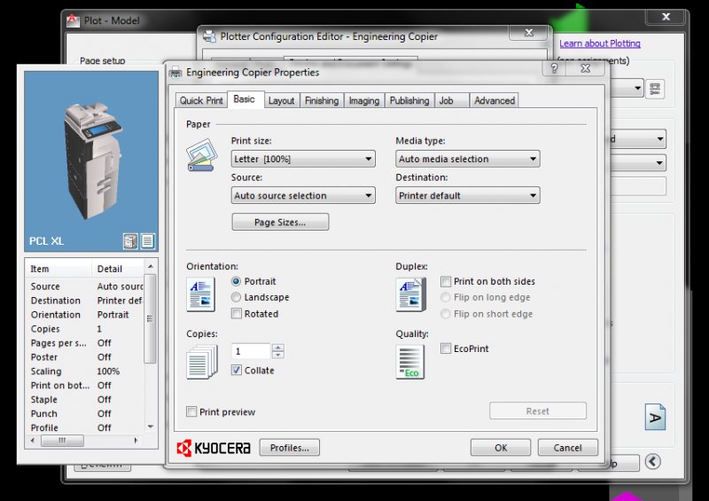

ReMark Posted September 6, 2012 Posted September 6, 2012 Maybe you made a change via Custom Properties specific to your printer (see where it says Orientation)? If so, maybe it is overriding what you set in your plot dialog box. Quote

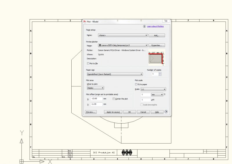

ReMark Posted September 6, 2012 Posted September 6, 2012 Top image. Expand the Plot dialog box so we can see what the orientation has been set to in AutoCAD. Quote

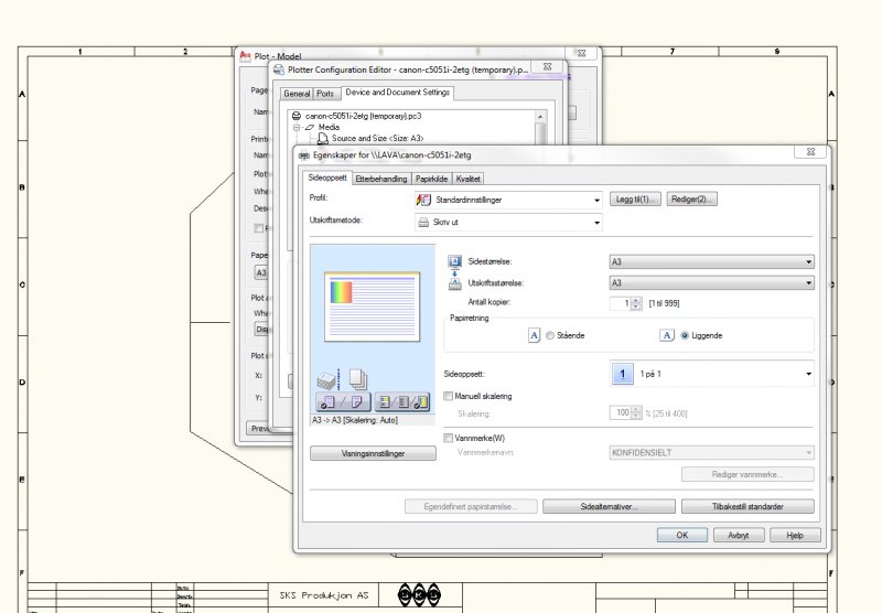

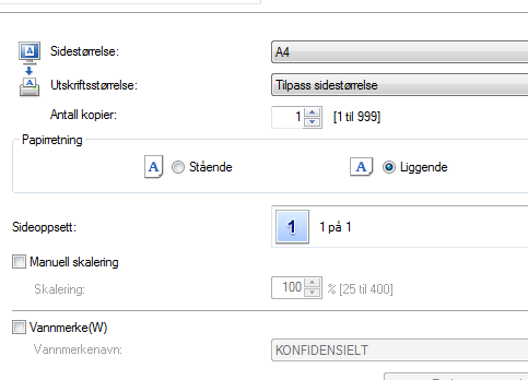

Willum Posted September 6, 2012 Author Posted September 6, 2012 Bigger picture. It means standing or laying. Quote
ReMark Posted September 6, 2012 Posted September 6, 2012 Please see post #12. THAT is the image we need to see. It is of the right hand (expanded) side of the AutoCAD PLOT dialog box. Quote
Willum Posted September 6, 2012 Author Posted September 6, 2012 I just found the button too expand the dialog box. The orientation was on portrait and when i changed it everything was correct. Thank you ReMark:D:D Quote
