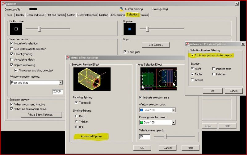

no dotting of locked layers while selecting?
locked objects get selected, but nothing acts on them. that is i do see them getting dotted while i selected all objects on other unlocked layers. is there way that locked layers don't get dotted while selection? just like in sketchup?
In OPTIONS > Selection Tab > Selection Preview > Visual Effect Settings > Advanced Options ......
as shown in the image sounds like you are hoping for. :)
that's not working. !! how could it be? still no change. restarted my system and autocad twice :( . however i i hover my mouse over it it doesn't get highlighted and dotted. i wanted that if i select, [i.e with the selection window], it should not get highlighted.

If you use command first, then select they won't be highlighted, if you select first then enter command they will be highlighted.
aaah i see. was doing it allway wrong. thanks :)
