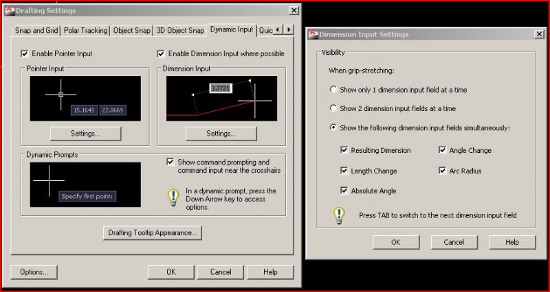

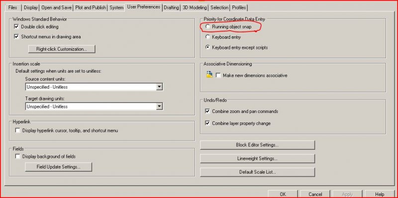

You need to prioritize RUNNING OBJECT SNAP for coordinate data entry.
You may be more comfortable with DYNAMIC INPUT (F12) turned off.
Then too you may want to check your DYNAMIC INPUT, Dimension Input settings preferences, as shown.
There are options available which greatly affect how you use the command.
