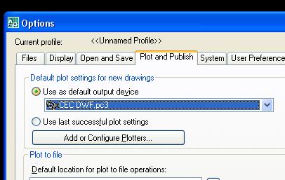

type OPTIONS, go to the plot and publish tab......at the top you can set the defaut plotter
