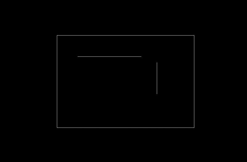

gsksun4 Posted September 12, 2012 Author Posted September 12, 2012 Post a portion of the drawing so we can have a look. Having trouble uploading the file. Thought I had the instructions. Looks like I just inserted the image. The original file is too big to upload, so I threw this together fast. These few lines also plot the same way, so it's the plotter. Can't find the Manage attachments button. Sorry. Quote
gsksun4 Posted September 12, 2012 Author Posted September 12, 2012 TEST.dwg Post a portion of the drawing so we can have a look. OK, it's been a while since I've done this. Guess that's it. It's seems to be there twice. Can't undo, so maybe that will help. They're closing up here, so I'll check in tomorrow. Thanks Quote
Dana W Posted September 13, 2012 Posted September 13, 2012 [ATTACH]37115[/ATTACH][ATTACH]37115[/ATTACH] OK, it's been a while since I've done this. Guess that's it. It's seems to be there twice. Can't undo, so maybe that will help. They're closing up here, so I'll check in tomorrow. Thanks I just plotted the dwg to a 36" pdf file at 4:1. (attached) In the pdf, the lines are arrow straight, no pixelation anywhere, no deviations. If they were off the ortho line, they would pixilate on the screen view of the pdf as well. I still say it is the printer. Maybe it's a head alignment problem. TEST-Layout1.pdf Quote
gsksun4 Posted September 13, 2012 Author Posted September 13, 2012 I just plotted the dwg to a 36" pdf file at 4:1. (attached) In the pdf, the lines are arrow straight, no pixelation anywhere, no deviations. If they were off the ortho line, they would pixilate on the screen view of the pdf as well. I still say it is the printer. Maybe it's a head alignment problem. Dana, I reset print preferences/speed, etc. All the settings were for quick plotting as I also print out a ton of PDF's most days for bids and it's a time issue. Slowed things down and it plots fine. I'll just plot the finals slower, then speed it up for the rest. Thanks for your help as always. Glenn Quote
