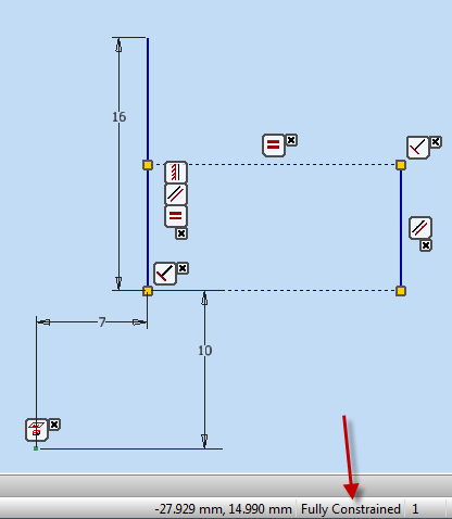

KarolR Posted September 19, 2012 Posted September 19, 2012 I want to make two lines or more to start at the same distance from the x or y axes. I can dimension the lines the same distance, but, maybe there is a better way? Is there any adequate type of constraint that can be applied? Quote
JD Mather Posted September 19, 2012 Posted September 19, 2012 You could add construction lines, make them equal constraint and dimension only one. I use more construction lines in Inventor than I have in any CAD since leaving the drawing board back in 1987. Quote
KarolR Posted September 19, 2012 Author Posted September 19, 2012 i didn't explain myself clearly. The lines are perpendicular to the x axis. I want that their starting points be at the same y coordinate. Quote

KarolR Posted September 19, 2012 Author Posted September 19, 2012 Instead of the two distance 10 dimensions, maybe something better... For test.ipt Quote
JD Mather Posted September 19, 2012 Posted September 19, 2012 In most designs there is usually some sort of logical relationships between geometry. Assuming 16mm line equal to distance between lines and shorter vertical line half the length of 6mm line - 3 dimensions (the constraints were all added automatically by Inventor). ...if this example problem doesn't answer the question - then post a real problem for suggestions on how to simplify/improve. Quote
KarolR Posted September 19, 2012 Author Posted September 19, 2012 Are the dashed lines construction lines, or inference symbols? I have 2009, maybe difference in appearance. How did you make the inference distance to be same length as the long line, without a dimension? As far as i know when you infer, it doesn't tell you when the length is equal to something. Quote
JD Mather Posted September 19, 2012 Posted September 19, 2012 In the upper right corner of your sketch screen you will see toggle buttons for Construction and Centerline types. In the image I attached you should see an equal = symbol next to the 16mm vertical and the upper horizontal lines. Quote
Bishop Posted September 19, 2012 Posted September 19, 2012 The dashed lines are construction lines, yes. He used an Equal constraint on the construction lines - see the equal sign above the top one - that set the length of it to the same length as the longer of the two lines. If he changes the 16mm dimension, the distance between the two lines will also change. Quote
