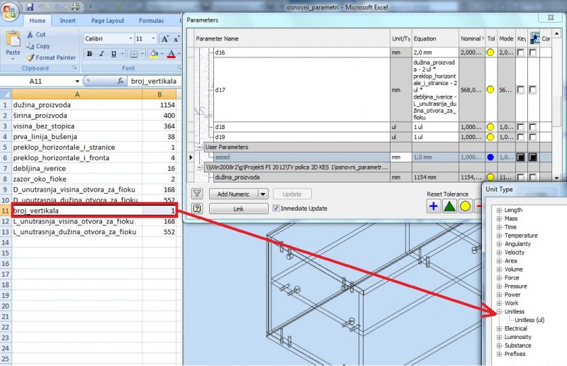

Be_cool Posted September 26, 2012 Posted September 26, 2012 As you can see from title i dont know how to define one parameter in excel so i can use him later to define NUMBER of patterns (for one component). Every time when i link parameters to Inventor their unit is mm, but i need for one of them to be ul (utinless) so i can use him to define number of patterns and contole whole product from excel table. Thnak you in advance! Best regards, Alex Quote
JD Mather Posted September 26, 2012 Posted September 26, 2012 3 columns in spreadsheet, 4th column can have comments. Variable_name, value, units, comments broj_vertikala 1 ul (if you leave the third column blank Inventor assumes document units, in this case mm) Quote
Be_cool Posted September 27, 2012 Author Posted September 27, 2012 Super!!! Thnak you very much JD!! Quote
