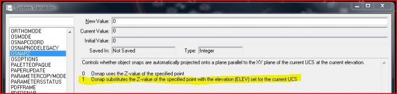

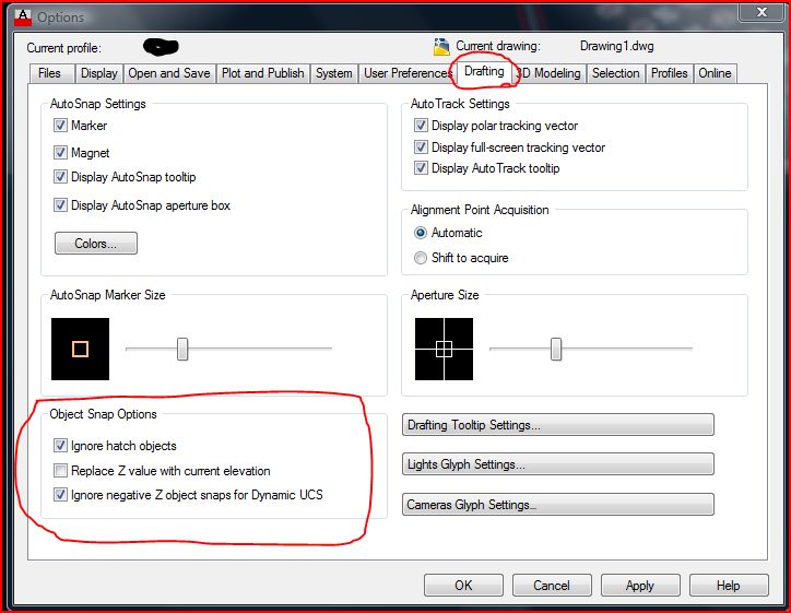

Dadgad Posted September 28, 2012 Posted September 28, 2012 Thanks for your reply. That's odd. I'd not tried pressing T then enter before. Interestingly, it works in most drawings, but not in the ones I've been having problems with! Regarding Z values, I've normally do it with snap off (roughly, by eye). So am I right in thinking z values wouldn't come into it if that's the case, i.e. it should be picking things all on one plane? What surprised me was that even with numerous points with different Z values, unrelated to the current UCS, it still worked fine. To ensure consistent Z value you can set the OSNAPZ variable to 1. Of course if you create a POLYLINE it will be flat too, but you want to pick random points, which essentially describe a region, and once again flat or not it seems to work fine for me, even with my OSNAPS off. Have you tried using the -PURGE command on the problem drawing, and AUDIT? Quote
Mr.Alex Posted September 28, 2012 Author Posted September 28, 2012 Thank you, I didn't know about setting the OSNAP Z value to 1, that's very handy to know. It's given me a headache a couple of times before! Quote
Dadgad Posted September 28, 2012 Posted September 28, 2012 You're welcome. For those working on a 2D drawing there is no good reason not to set the OSNAPZ variable to 1. In the image OSNAPZ is shown as set to 0, as I work mostly in 3D. Quote
