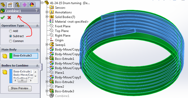

I made the spiral and barrel, now i hide the spiral but i don't see the cuts in the cylinder.
I want to make a round thread with the spiral, i wanted it to remove material from the inner cylinder, but although i unchecked Merge Result in the Extrude Property Manager, i don't see the thread.
41-24-15 Drum turning.SLDPRT
You could have saved a lot of work with a simple Helix Sweep-Cut for the entire number of turns rather than copying them and then a couple of Extrude-Cuts on the ends.
For your solution - Insert>Feature>Combine - Subtract
