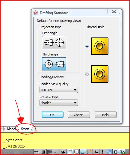

Dadgad Posted October 1, 2012 Posted October 1, 2012 Don't give up on viewports they are definitely very important, it just depends on what you are trying to do. But just in case they should want you to whip out a quick set of views of a 3D model, you need to be ready to use that. Have you also explored the SECTION and DETAIL functions in VIEWBASE? By right clicking on the LAYOUT tab you can set the Drafting Standard PROJECTION TYPE to whichever is appropriate where you are. Remember that if there are any questions about UNITS, the -DWGUNITS command is your best friend. You're gonna do great, but don't get cocky now, there are plenty of folks who are quite good with this software. Quote
