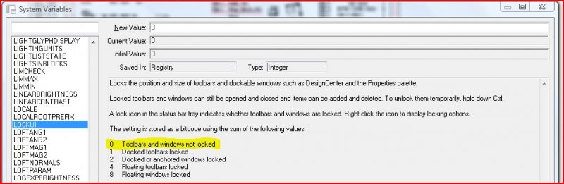

Make sure that your WORKSPACE is unlocked as shown in the image, by resetting your LOCKCUI to 0, or unlock the workspace padlock in the lower right hand corner of your screen.

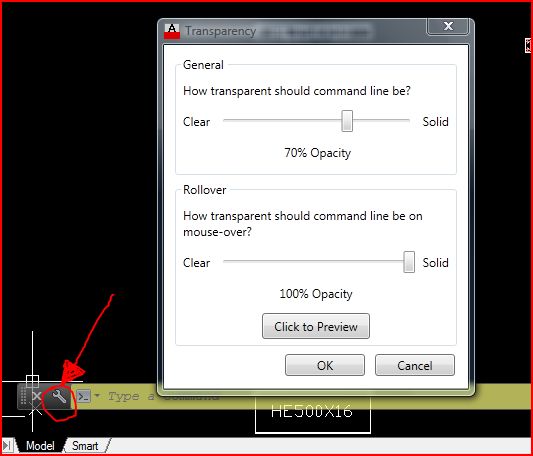

After that you should be able to change it by dragging, right clicking and the little wrench icon at the left hand end of your commandline.

click on the vertical bar on the lefthand side of the command pane and drag it until it docks on the bottom, if you don't want it docked on the bottom of your graphics screen click on the little spanner to set it up as you want. Once you have it set up save your workspace overwriting the previos one. That way it should remain as you want it.

Thank you both. Followed Dadgad's clear instructions and all sorted :)
