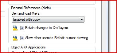

Ok. I opened both files. The x-ref didn't load.
Closed the layout file. Change XLOADCTL to 0 while the FV.dwg is still open. Opened the layout file and the x-ref showed.
Closed everything. Opened both files. The x-ref didn't load.
Closed the layout file. Change XLOADCTL to 2 while the FV.dwg is still open. Opened the layout file and the x-ref showed.

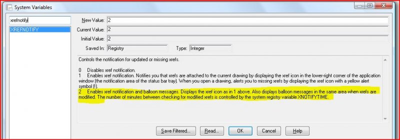

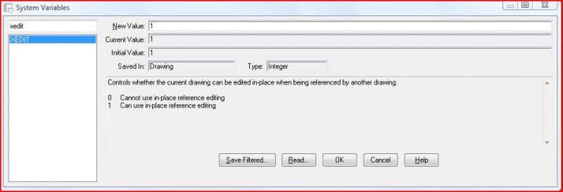

XNOTIFYTIME does not appear to be a real variable, now they are making stuff up!
