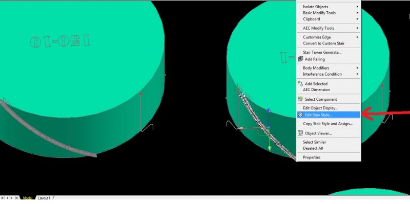

I have a 150'Dx48'H tank and the stairs need to revolve around like 38-40 degrees. The tread height dictates the number of treads witch dictates the distance (= the degree(length) around the tank..
I can't figure out the over ride for this...
Is it not in the Style? Last I messed with the Stair Style there were a ton of options to manipulate. For me to help out, I'd have to exercise my AutoCAD MEP knowledge pretty hard I bet.... it's been too many years since last I monkeyed with it.
once again Styke you have inspired me to go where no man...(well me anyway)... has gone before...
thank you for the help as usual!
Awesome, glad you found it. Last I remember, it could get pretty intense messing with Stair and Railing Styles. I never could completely master it, but then again I never had to put my main efforts into Stairs and Railing either. ;)
