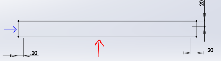

Cannot extrude sketch

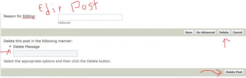

I don't know if this works on an orginal post or only on Reply posts.
I don't have this button, if i had i wouldn't have asked
It is usually appropriate to supply the solution here so others with the same problem can benefit from your solution.
The OP can only be deleted by Admin and Mods.
For those of you who come along and try to solve the problem -
Note that one of the lines in the sketch is thin, while the others are thick. (red arrow)
This indicates extraneous geometry somewhere in the sketch.
There are double lines overtop of each other on the left side in this image (blue arrow). Deleting one of them fixed the sketch.
