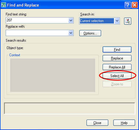

I'm not sure about AutoCAD 2009, but in 2010, the 'Select All' button is here:
[ATTACH]37613[/ATTACH]
But it is not present in AutoCAD 2009. I'll try to have 2010 Version.
Out of interest, what does the 2009 Find dialog look like?
After looking at the FIND dialog box for 2009 I think you should be clicking on the "Replace All" button since there is no "Select All".
I just installed Cad 2010, It has Select All button.Thnx.
