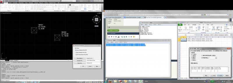

the Manhole have 3 attribute : Name, Model, Level, (and the X-Y coordination),
I Create a Block with attribute "Name ; Model ; Level".
and then I insert the Blocks and place it in correct location inside the Layout Plan.
Then I have no idea, how can I create some script to "Scan" all Block inside the drawing and make an excel file with data like:
Block-Serial, X-Coor, Y-Coor, Rotated Angle, Name, Model, Level....
Could any one give me some idea to start my plan?
The Attibute extraction tool work like a charm (the DataExtraction ReMark has mentioned may be built up this, but I am using LT and cannot use it). You can export the Attribnute information based on attribute name, as well as block postion. You can then take the exported txt file and import into excel very quickly.
Opps~!!!!! That Exactly what I am looking for~!!!!!!! Thx a lot~!!!
I could then process on writing the excel file to analysis the data~
