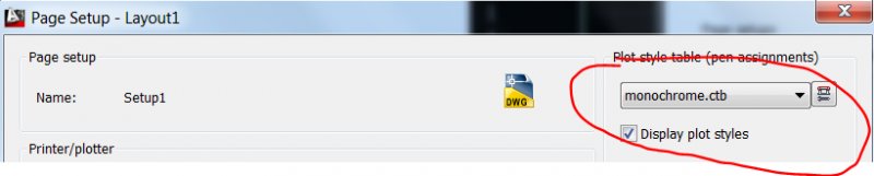

ALL OBJECTS BECOME WHITE COLOUR. IN LAYOUT.:x
I assume you have set your Plot Style to Monochrome (which is correct for B/W prints)
but by having Display plot style turned on - that is what it is doing, displaying in monochrome.
[ATTACH=CONFIG]37638[/ATTACH]
:shock: yes yes yes thanks a lot Mr. JD Mather, i tried most of thing except this.... any way thanks again :shock:

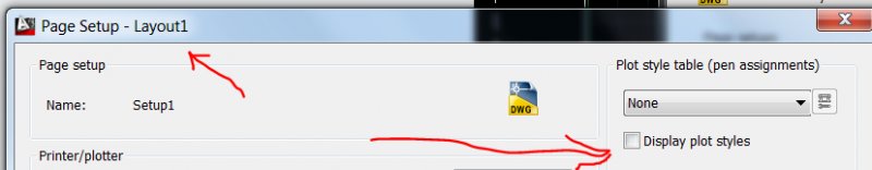

I have the same problem and checked everything what's in this thread:
No VP color overrides;
No Plot Style
Don't know what can be the problem...
Then simply attach your dwg file here (only need one line in the file).
