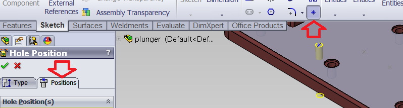

Click on the second tab - Positions.
Check the sketch point creation It should already be checked. (you already have your points so just click on the to create coincident relations with the hole centers).
Now you should be able to select your points.

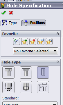

Post screen shot of your Hole Wizard dialog box.
Hole Wizard.PNG a picture something like this.
oh, i know this dialog box, indeed i used it, but the Simple Hole creation wizard doesn't have such a complex dialog box. it only tells you to select a plane, that's all
