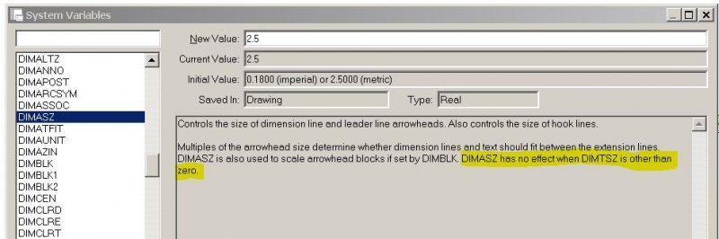

The size of arrow is controled by DIMASZ system variable.

I understand that the arrow scale is controlled by the dim style, I was just wondering if there is another variable (other than DIMSCALE) which could be affecting the arrow scale.
Mircea is right about that, as shown in the image :thumbsup: , but I am still curious about this.

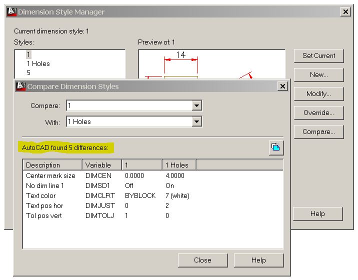

Can you post a little snippet of a drawing containing both of the dimension styles?
I think we need to use the COMPARE option in the DIMSTYLES MANAGER to better understand what is going on here.
The DIMASZ variable is the one in your DIMSTYLE described as ARROW SIZE.
