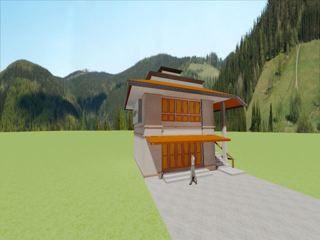

mugshot Posted November 8, 2008 Author Posted November 8, 2008 The best way is you should need to save your perspective view.To do set the sky in model space is...type in command line ...skystatus :0 (skyoff) : 1 (sky background) : 2 (sky background and illumination) you can choice as you want Then you will need to set sky setting from your save view ... "V" enter.. you will see view manager dialog box and select your save view then select sun & sky from background drop down list and adjust sky setting from sun & sky background dialog box according to model view sky setting. These two setting will help you that can get right setting of sun or sky to your render result. If you will need custom sky,you can select image from background drop down list of save view manager dialog box. :oops:guys... see the difference between these two pics... the other is created with sky backdrop but the cast shadows were too dark, unlike on the other pic, it had no sky but the shadows it cast was still visible. what i would like to happen is to come up with a sky bakdrop and shaded part of the structure to be visible... is it possible to combine these 2 drawing that each others negative aspect shall be remove? Quote

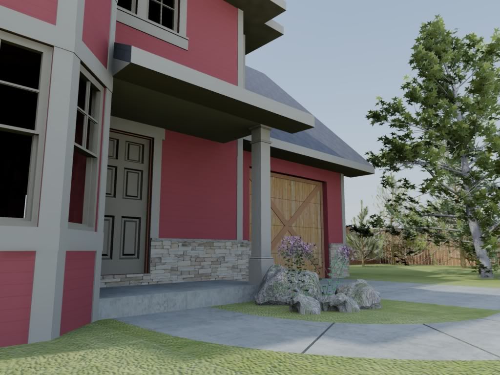

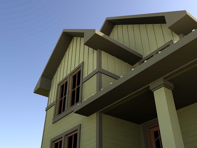

Noahma Posted November 8, 2008 Posted November 8, 2008 you should have sky to be on, with background and illumination. Change your geographic location and sun angle so that you get the desired shadows. If you need the sun to be more intense, bring up the numbers, you can do the same to the background. Dont change the color of the sky, the color that is default is very close to what is out there. The sky background and illumination adds more scattered light that has been affected by the sky in general. I usually do not use background pictures, it is very hard to get the light to match between them. these are the images I get with it turned on. please ignore the floating window trim lol. Quote
mugshot Posted November 8, 2008 Author Posted November 8, 2008 ... the main concern here is the difference of the shadow that is being cast on the structure.... i have used the image so that you guys have an idea on what my problem is... ( i know that sky image is not appropriate but sometimes good minds comes from silly ideas). Quote
papagyi Posted November 8, 2008 Posted November 8, 2008 Do you means like this?I used sun and custom image from save view. Quote
mugshot Posted November 9, 2008 Author Posted November 9, 2008 yup! thats it!!! ill try it later on... i'll post whatever the result.. thanks though:lol: Quote
