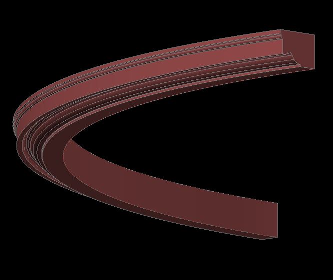

ReMark Posted October 10, 2012 Posted October 10, 2012 I'm not sure I've done your profile justice but consider this an example of a profile that has been swept or extruded along a curve. Quote

ReMark Posted October 12, 2012 Posted October 12, 2012 You create your profile as a closed polyline. Then you have two options: Extrude or Sweep. Sweep can have some unexpected results so one must be familiar with and pay close attention to the various options. Extrude has less options. Either way you must have a "path" defined. This path can be a straight line or a curved line or a combination of the two. Once you have extruded or swept the profile any further refinements can be made with the other solid editing tools such as Slice. Quote

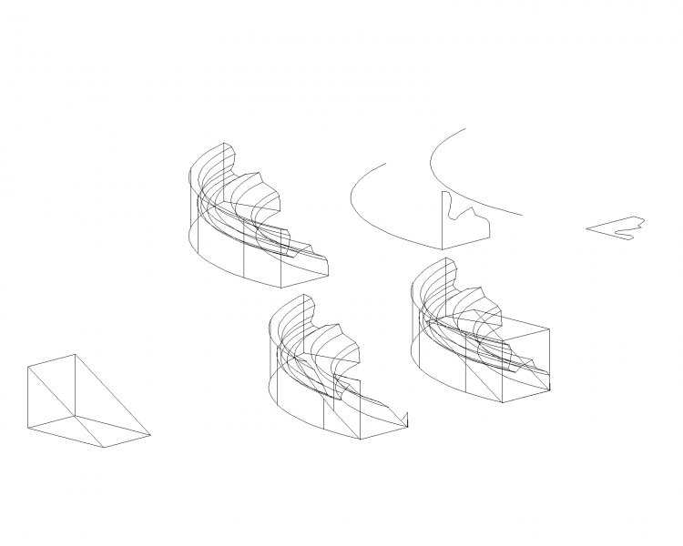

BIGAL Posted October 12, 2012 Posted October 12, 2012 3d modelling is part time for me so others will do better but here is a 5min effort. The shape is drawn as a pline, an arc added use rotate3d to lift up shape to end of arc but planar to arc. then extrude. Draw a wedge for trimming extrude it realign it using rotate3d then use subtract to cut the wedge out of the moulding. Moderator please remove duplicate image please let me know how Quote
