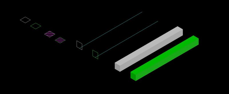

Just an observation.
The white square is a closed polyline and the green square is a closed polyline.
Both were hatched.
Both were extruded.
Their areas report back as being the same.

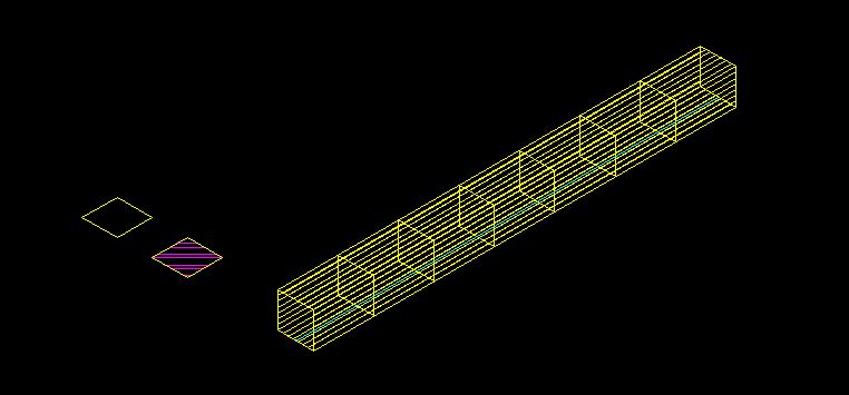

Another observation.
The box is comprised of four separate polylines.
It can be hatched.
It can be extruded yielding what AutoCAD calls a SweptSurface.
