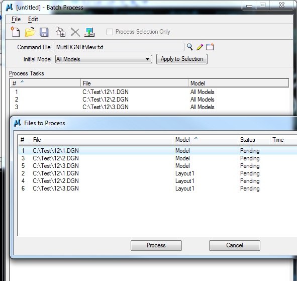

s its working fine...But if some dgn having Model & Layout...Here i want action only for Model view and out put also same..But here its coming reverse..how to ignore or remove that Layout??I cannt able to remove that Layout..Each Dgn its showing One Model & One Layout and out put also coming with Layout view...but i want consider model view only output also required same model window.
suryatry26, in the Batch Process dialog set the Initial Model to Default Model Only instead of All Models. That should work for what you have.
Regards,
Bob Mecham

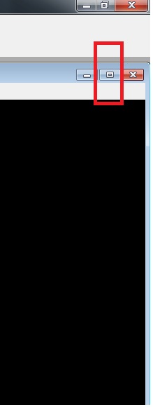

Here We can possible to include File Maximize (Which dgns availble in Restore format) Option?
suryatry26, not exactly sure what you are asking for. The keyin to "file maximize" would be "fit view extended"
HTH,
Bob Mecham
That Red Marked Inside Window i want to maximize..I want to include this Command.I think "file maximize" Command will not work for this?
Thanks for the screen capture. The best keyin I could find would be "window tile" or "window tile;fit all;dx=0" that is if only one view is open. There is also "window cascade" that will cascade all open views.
I could not find a window maximize keyin.
