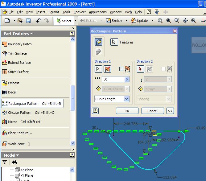

KarolR Posted October 11, 2012 Posted October 11, 2012 I tired to make a rectangular array of the single solid along the path. In the preview there is a problem, the array doesn't follow the path, and when i press ok it isn't created at all. Part1.ipt Quote
JD Mather Posted October 11, 2012 Posted October 11, 2012 Your origin Center Point does not make logical sense to me? Most of your dimensions in Sketch5 do not make sense to me. Workplane1 is not needed - why did you create that? There is a Tangent constraint missing in Sketch5. But even with all those problems - don't see why it won't work, something is fishy with Sketch5. I recommend you start over from scratch and create the path in Sketch1. Do not create the extra workplane. Attach the new attempt here. When I recreate - this is what I get, I assume this is what you are after. Quote

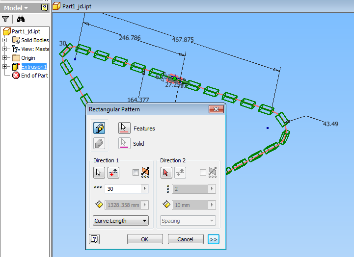

KarolR Posted October 12, 2012 Author Posted October 12, 2012 I made the sketch anew, and this time no errors and it let me make the array, but it is shifted Part1.ipt Quote
JD Mather Posted October 12, 2012 Posted October 12, 2012 Tip # 41 http://home.pct.edu/~jmather/SkillsUSA%20University.pdf Quote
KarolR Posted October 12, 2012 Author Posted October 12, 2012 But when i use the start point option the mouse's arrow has a + sign near it and i touch the path in various places but nothing happens, when i press ok it remains the same Quote
