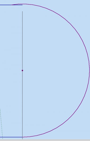

Your sketch is not constrained not symmetrical.

But first you should clean up the 2D sketch.

You should be able to create a sketch like that and have Inventor automatically apply tangent constraints.
Click and drag arc of of lines while still in line command.
