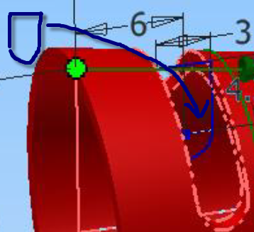

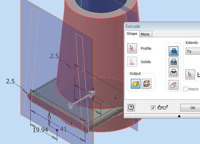

I want to extrude 3D sketch 3 perpendicular to the cone, but i cannot select it, and if i select the base sketch, sketch 2, it extrudes right up or down.

You can't extrude a 3D sketch at all.
Make your 3D sketch into surfaces, then extrude a 2D sketch between the surface and the cone.

no, i didn't want it this way, i wanted the cut to be perpendicular to the cone face.
Extrude cuts through in a vertical way, perpendicular to the 2D sketch.
I want to make what you did in tip no' 39, you can see there how it's supposed to be.
That was made with an Extrude - Cut of the U shaped sketch as shown below.
Other alternatives are Split Face with your sketch and then Thicken(Offset) - Cut.
