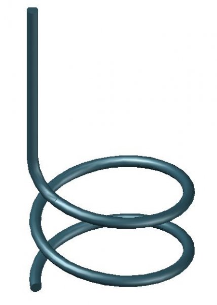

ReMark Posted October 16, 2012 Posted October 16, 2012 What if you bevel the end of your elbow so it matches that of the end of your helix? Quote
ReMark Posted October 16, 2012 Posted October 16, 2012 My feeble attempt using the idea mentioned previously. I'm done playing now. Quote

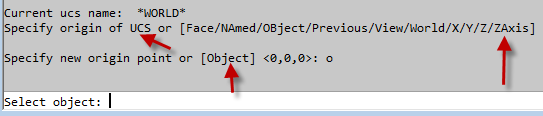

JD Mather Posted October 16, 2012 Posted October 16, 2012 I recommed learing the UCS - ZA - O options to create stuff lined up if you do a lot of this type of work. In my experience, few understand the ZA option of UCS Quote
Dadgad Posted October 17, 2012 Posted October 17, 2012 I recommed learing the UCS - ZA - O options to create stuff lined up if you do a lot of this type of work.In my experience, few understand the ZA option of UCS [ATTACH=CONFIG]37895[/ATTACH] Good point and solution JD, better than 3DALIGN in a case like this. Quote

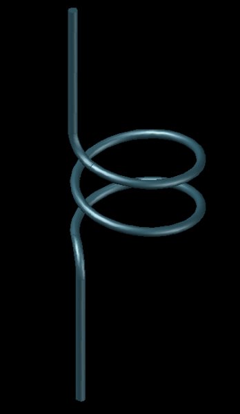

Buzza Posted October 17, 2012 Author Posted October 17, 2012 Ive had another play this morning, couldnt get the 3d align working or the UCS Z Axis. I think its worked out pretty good this time. I originally wanted the vertical pipe section to be seperated abit with a gap between them. to achieve that the helix would of had to have about 1.8 / 1.9 turns but this set 1 end off on an odd angle. I presume the ucs z axis would of let me work on that angle abit eaiser. Using a full 2 turns left me work on the standard top/front/left planes which made the right angles abit easier. It's still not aligned 100% but it looks ok. Thanks for everyones advice. Attached Update: Coil2.dwg Quote

JD Mather Posted October 17, 2012 Posted October 17, 2012 Ive had another play this morning, couldnt get the 3d align working or the UCS Z Axis. Be aware that there is a significant difference between UCS Z option and UCS ZA option. This is what I referred to earlier as most not understanding the significance. If you really want to do stuff like this http://home.pct.edu/~jmather/content/DSG322/Inventor%20Tutorials/Inventor%2011%20Tutorial%207.pdf Quote
