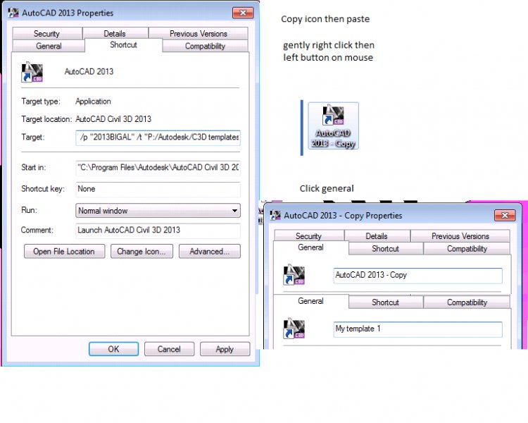

Make a copy of your desktop icon and edit the properties after the /p "myprofile" add /t "f:/server/dir1/mytemplate" etc rename the description Template1
Thanks BIGAL. I don't see where to make these changes in the shortcut properties, but it's not a problem.
It's just that when a program seems like it's supposed to behave a certain way and it doesn't, then either something's wrong or I don't understand how it's really supposed to act, and that irks me (even if there's an effective work-around). Thanks, though.
Copy the application icon (on yor desktop?), right click, choose properties, make the noted changes to the "Target" property. Be sure to change the name of this version of your application icon to something indicative for clarity. :thumbsup:

After changing Qnew to blank you probably need to resave the profile otherwise next time you start it ignores what you have set.
A way to do this is save a new profile make current then edit your Target line in your desktop icon after the /p like above to match location of new profile saved.
