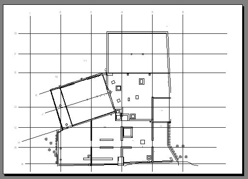

lufc100 Posted October 18, 2012 Posted October 18, 2012 Hi all, When I try to plot my drawing, my drawing only takes up 2/3 of the page on print preview. The top half of the page is blank. How can I make my drawing take up the whole available page? Quote

lufc100 Posted October 19, 2012 Author Posted October 19, 2012 S0200_Smmc.dwg JD No I'm printing from the model. Please find attached the file I'm trying to print. Quote
tomhamlet Posted October 19, 2012 Posted October 19, 2012 If you are just printing from model space, make sure your print option is set to "extents." However, if your drawing is not proportional to the ratio of the paper that you are printing on, you will have blank space. But I would also agree with the above comments. Set up a border that you can add to any paper space, wether via block or template. It will make future drawings easier to print and organize. Not to mention it looks more professional, I have yet to see a working drawing that does not use a title block. Quote

rkent Posted October 19, 2012 Posted October 19, 2012 You will have to provide more detail. What size paper are you plotting to? Are you using Extents or Window or ... when plotting? Are you seeing all of the drawing and it isn't filling the space? What you have is fairly square so there is no way to have that fill a rectangle. Define a rectangular window and then it will fill a rectangular page. Quote

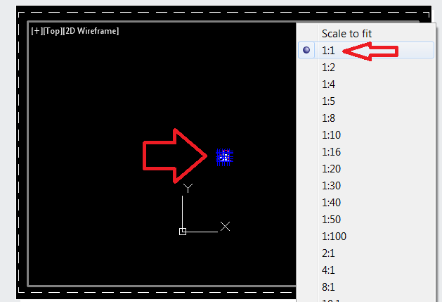

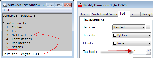

eldon Posted October 19, 2012 Posted October 19, 2012 Try selecting the area that you want to print using a Window, and plot "scaled to fit" And perhaps your geometry is full size in metre units. Quote
JD Mather Posted October 19, 2012 Posted October 19, 2012 And perhaps your geometry is full size in metre units. This is what AutoCAD tells me......... Quote
eldon Posted October 19, 2012 Posted October 19, 2012 This is what AutoCAD tells me......... Sometimes one has to do a bit of detective work on your own, and see what is actually happening, rather than slavishly believing what AutoCAD tells you. Not everybody is perfect Quote
eldon Posted October 21, 2012 Posted October 21, 2012 If you check the hozirontal grid spacing, it is 7 units (or thereabouts). The UC blocks are inserted at a scaling of 0.001. Therefore whatever the units may be set to, the drawing entities are in metre units. Quote
