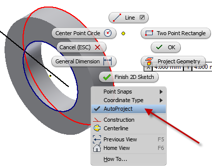

I assume you are aware that there are two options in Tools>Application Options>Sketch
Autoproject edges during curve creation (this is also on right mouse button in sketch environment - might accidently turn that on when using right mouse button).
Autoproject edges for sketch creation and edit.
also the dimension tool can autproject an edge. (I assume you are aware of all of this, but trying to cover all the bases.)
