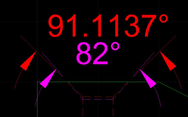

Your angle is 91°, not 82°.
Wrong line type. (should be hidden)
Extra lines in RS view and missing countersink hidden lines.
The hole (ellipse) is shown correctly in RS view.
and yes, you need that hidden line in FV for the "negative cylinder" feature (hole going through the part.)

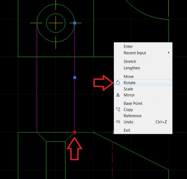

I saw your example but I guess what is throwing me for a loop is if I do 82 degrees from the outside diameter of .50 it doesn't want to intercept the inside diameter line until its almost at the bottom of the part. Making more of a cone than an countersink.
I guess an easier way of asking this would be is there anyway using projection lines to get the depth of the countersink?
Maybe I am figuring the angle using the wrong points. I was simply going by the top of the part, or the horizontal line representing the top then going 82 degrees down from that.

The angle which is described by that value is further clarified in the image.
It represents the number of degrees between the cutting edges of the tool which creates the countersink.

You have the circles projected correctly (see magenta lines).
Select one of the projection lines and then select the end grip (now highlighted red).
Right mouse button and select Rotate.
Rotate the line -41°.
Repeat with the other line, this time rotating +41°.
Now extend the two lines till the meet in V shape and then trim the excess.

THANK YOU!
JD, and Dadgad you are gods!
You not only understood what I was trying to convey in my post, a brilliant feat in itself. But you were able to explain it to me so I could comprehend it.
Dadgad the explanation how to find the angle and more importantly what the angle was measuring was a great light bulb moment.
And JD your technique for creating the countersink was another ahaa moment. I knew it had to be easier than I was making it.

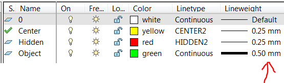

Change the lineweight on your layers and it will look better when printed.
Good job on first part.
Thanks again JD,
These are just going to be e-mailed to my instructor, no printing as of yet, and we have not even talked about using line weights other than default, so if he wants them changed it will be news to me. I am sure I will have more questions later, have a great day and thanks again.
