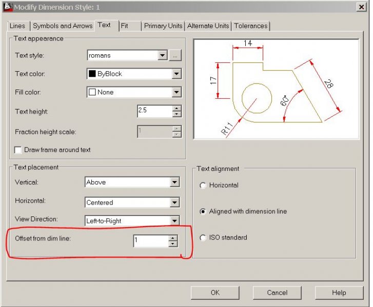

Arty Posted October 22, 2012 Posted October 22, 2012 Hi! Is there a way in AutoCAD 2012 to set a distance between a line and the text above it? Would be nice to be able to mark all my bearings and set a distance so all of them ends up with the same distance from the line they refer to. /Arty Quote
Dadgad Posted October 22, 2012 Posted October 22, 2012 In your DIMSTYLE manager on the MODIFY DIMENSION STYLE dialog, as shown in the image, on the TEXT tab. Quote
BIGAL Posted October 22, 2012 Posted October 22, 2012 A bit extra if you want just the text you can turn off the arrows and lines etc also. Quote

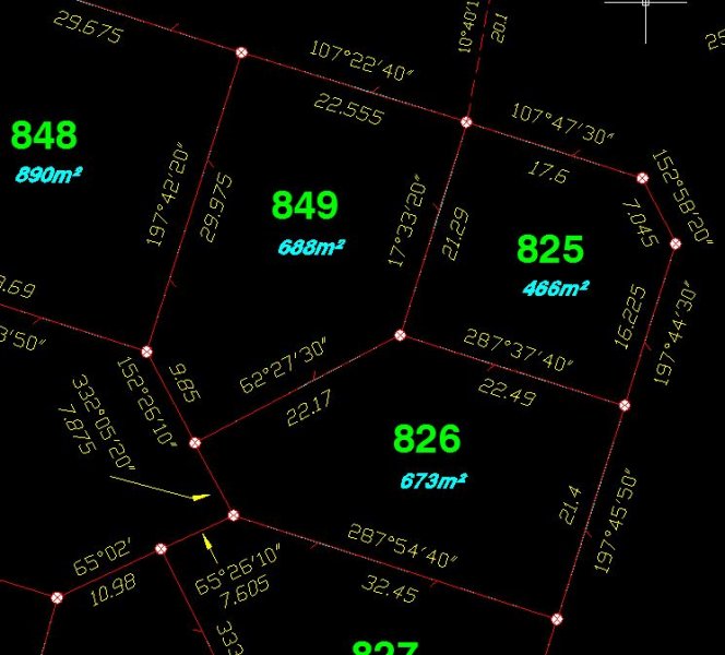

Arty Posted October 22, 2012 Author Posted October 22, 2012 This is what i looks like, well part of it, and I want to get less space between distance/bearings and the lines surrounding the lots. Both distance and bearings are just text. Quote
nod684 Posted October 22, 2012 Posted October 22, 2012 no wonder it's not working for you...because the solution presented was for dimension without the dimension and extension line. maybe a lisp will help you on this but am afraid i am not that knowledgable on lisp to do it for you... Quote
Dadgad Posted October 22, 2012 Posted October 22, 2012 I am sorry that in my first response I mistakenly assumed that you were talking about the relationship between dimension text and the dimension line which it describes. I am not sure how to resolve this, unless maybe creating a block for this purpose and making use of fields. Come to think of it, if you created each of them as MTEXT containing 2 lines, justified middle center, you could affect the change by adjusting the LINE SPACING. I just looked for something on Lee Mac's excellent site, thinking Lee probably had something to help you, as he usually does. : You may want to take a look at this http://www.lee-mac.com/dtcurve.html Thanks Lee. Perhaps using this lisp combined with my earlier suggestion of creating a 2 line MTEXT and adjusting the line spacing, you may be able to do what you want. Quote
nod684 Posted October 22, 2012 Posted October 22, 2012 (edited) I am sorry that in my first response I mistakenly assumed that you were talking about the relationship between dimension text and the dimension line which it describes.I am not sure how to resolve this, unless maybe creating a block for this purpose and making use of fields. Come to think of it, if you created each of them as MTEXT containing 2 lines, justified middle center, you could affect the change by adjusting the LINE SPACING. nice suggestion he can easily convert the text to Mtext and adjust the line spacing EDIT : tried this but it doesn't move the text either it only increases the MTEXT "FRAME" Edited October 22, 2012 by nod684 Quote
Arty Posted October 22, 2012 Author Posted October 22, 2012 Sorry for being unclear. I'm not very skilled in AutoCAD yet and doesn't know the right words to use yet....sorry for misleading writing... This siteplan is lines, polylines and text... It's all loose peaces. It's drawin in LisCAD, by the surveyor, then taken into AutoCAD where I make the info readable and nice. Doing it this way I guess I'm not able to use smart AutoCAD features unless I redraw the hole thing. very sorry for wasting your time guys... but thanks for trying to help! Quote
BIGAL Posted October 22, 2012 Posted October 22, 2012 Your not wasting time Pick text, pick line and just redraw set offset to zero if you want two separate pieces of text using a lisp. Now do all in one go ? Theres some lisp out there that will find closest object to a line. Need that first then just relocate text to a new offset position. In a nutshell make two lists text and lines and say compare text insert point to midpoint of line. You need a reducing repeat. I will try to find an old brg dist routine I have and make it work on pairs if some one doesn't beat me first. Quote
