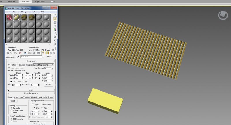

I need to add picture to a plane, but some how when i added the picture by bitmap, it showed the picture is compressed. kindly check the picture. How I attach the picture to the plate without any deform or being compress? ::?

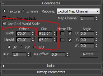

nope.. just set it as a face map if that doesnt work uncheck face map
and make this match your plane size
