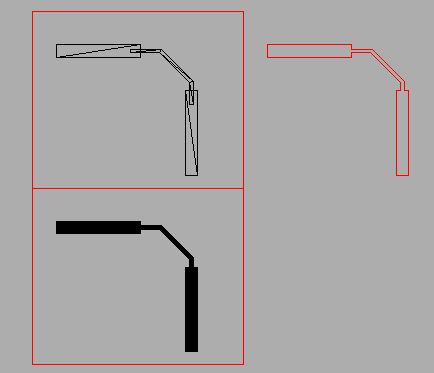

Here's a mockup of what I want to achieve:
On the left are three polylines (PL1, 2, 3), where PL2 has a different width and overlaps the other two polylines. On the right is the desired result: a single polygon (NOT a polyline with variable width) in the same shape as the polylines.

Probably better ways of doing it now, but I would WMFOUT the shape. Then WMFIN that file and scale it to suit the original. Then use BPOLY and there is your shape :D

If these polygons are simply 2D polygons, do this: Execute the Trim command, then trim off the overlapping areas. Excecute the Join command, select the object with the desired properties as your source object, then select the other objects as those to be joined. All the polylines will end up with the properties of your source object, and they will be one continuous polyline "Polygon". The join command will onl;y work if all your objects have at least one point in common, so don't separate them after the trim.

The three lines are polylines as I said. But that is not really a requirement, all I need to do is draw some lines roughly in the shape of my example (they represent a part of electrical contacts ultimately), I just used polylines because it's easy to change their coordinates and width in case the specifications of the desired contacts changes (quite often). I could build the entire final structure (right side of example) using a polygon to begin with, but that would be very cumbersome to work with, so I'd rather use polylines and then turn them into a polygon at the end.
It has to be a single polygon at the end, it cannot be a polyline with multiple segments of different width. I need to export the drawing to GDS finally (I actually export it to DXF first and use a different application to get the GDS), and those kind of 'multiple width' polylines aren't translated properly and turn out as just normal polylines with a single width.
They can also not be separate polylines (as on the left of the example), they must be one continous shape to avoid numerous complications.

@eldon: thanks. I just didn't understand anything that you said :unsure: I'll try tomorrow, but I've no idea what WMFIN/OUT are/do. It sounds as though the shape is going to be exported to some file and then imported again? Will that work considering that the example I showed is only going to be a small part of a bigger drawing (with many of these polylines that need to be merged, as well as other shapes)?
