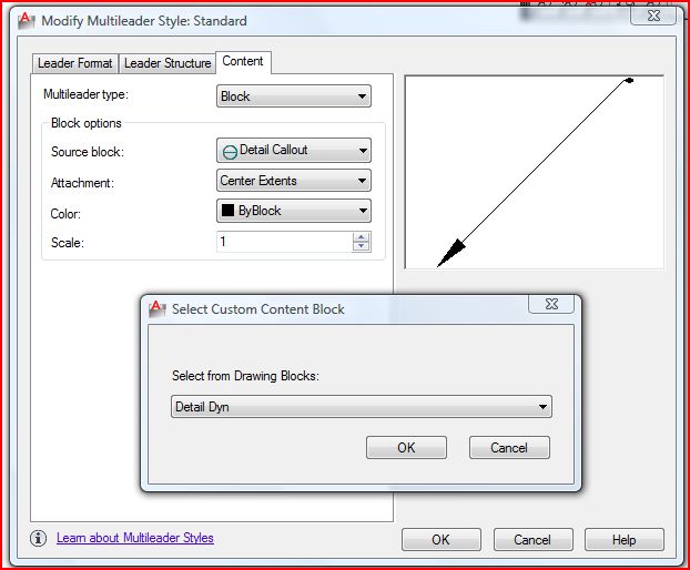

You might be able to do that by defining a new MULTILEADER style, instead of a QLEADER.
I have created the style like that Dadgad but am not able to set the block to explode....
What about adding ladder to your dynamic block?
Functioning Dynamic Blocks can't be added to Multileaders (that I know of). The block can be attached but you lose the dynamic functionality. A workaround is needed. You can create entities to simulate a leader, or they must be two separate entities if you want to use a leader/mleader.
There might be another solution, but I do not know of any. This has been a longtime request among the AutoCAD community.
