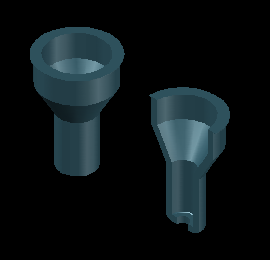

Couldn't you just use a couple of circles and loft them to create the cone? Or create the profile and revolve it?
Down and dirty. For informational purposes only.

No, not trying to create a custom fitting (it's a structure). I'll try the loft command and see what luck I have. The drawing ReMark posted looks a lot like what I need. As I stated just learning 3D.
Thanks
Thanks ReMark, greatly appreciated.
