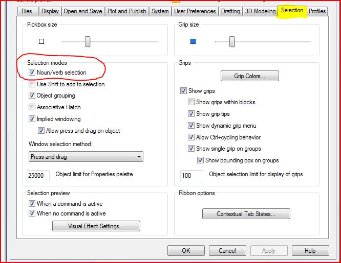

In general, we can select the objects first and then run a command. I have a problem with this, autocad wont let this in my PC. If i select objects and run a command, autocad wont take the selection and prompts to select objects. I work on PC in a company connected to server, but the problem is only on my PC.:(

It sounds like your OPTIONS settings on the SELECTION tab
are keeping you from being able to do that.
Refer to the image, and I believe that will solve your problem.

Am greatful to you it solved my problem. But why is that selection called NOUN/VERB.....!
That is the PICKFIRST system variable, and you want it set to 1, like most users.
